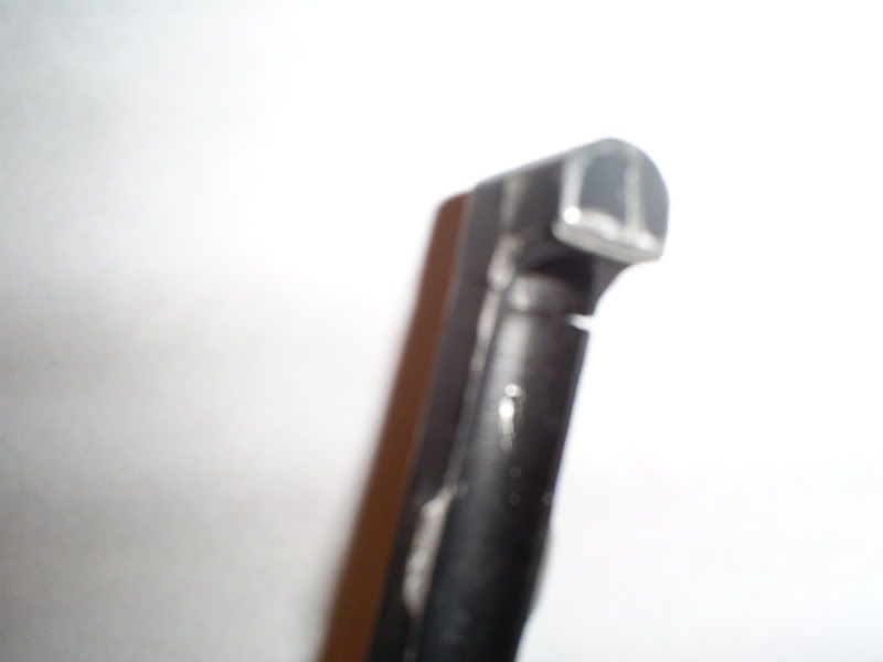

While Doing some Type #1 Malfunction drills today I noticed after the completion of the drill that my charging handle felt a little ruff or gritty. Not having cleaned my rifle in some time I assumed that it was just dirty, so I finished up and striped the bolt and charging handle to give it a wipe down. As I was wiping off the Charging handle it became very clear what the problem was, I had 2 large cracks going down the forward area of the Charging handle. I use a PRI Big Latch and love it, but its so easy to pull that the charging handle couldn't take the force. I hope that this is not going to be a common place occurrence and if it is I will either have to get a stronger charging handle or loose the Big Latch. This is a colt charging handle but it has been used a great deal by me and I'm anything but gentle. This is a rather new charging handle as well so I will have to do something to insure this dose not happen again, I just really don't wanna loose the Big Latch.
Anyhow just wanted to let everyone know its all to possible and keep it in mind when doing drills and whenever using the Larger Charging handle levers.

Before all is said and done be aware my charging handle gets cycled near 100 times every day despite if I'm shooting or not, it receives a substantial amount of ware it a way that is anything but gentle. Every drill is done with the same force one would use when it matters so there is excessive force, but necessary force.
The Big Latch supplies a much easier surface to grip and the angle of the latch insures you finger wont slip off, this results in all the extra force being transfered directly to the charging handle. With the standard handle believe it or not you finger dose slip off , it just happens so fast it almost like releasing it, either way the extra force is not transfered to the charging handle. It also increases the length allowing more are to contact the fingers increasing the force I apply once it has reached the end of its travel. Most people will never use there handle enough to remove the finish , some will, I posted this for them who will.
Here is a pic so you can get a better idea of the amount of ware on this handle, keep in mind this is about 18 months old possibly 20.

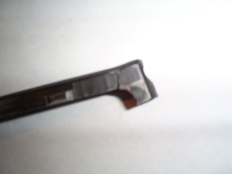

As you can see from the next pic it is a much larger latch and much easier to ally to much force.
